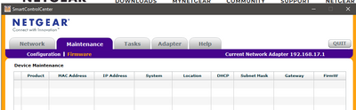

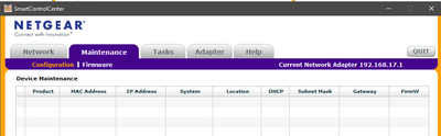

I wanted to update firmware for my Netgear GS108Tv2 Switch
but I cannot discover the switch with SmartControllCenter
I can login with the IP
and also the IP of the adapter is shown in CotrolCenter
but when I press discover nothing is found?
when I goto firmware nothing is there!?
What have I done wrong??

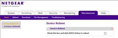

SCC is obsolete for various reasons (outdated run time environment)-
Use the device Web UI to update to the current firmware https://www.netgear.com/support/product/gs108tv2#download https://kb.netgear.com/000064041/GS110TPv2-GS108Tv2-Firmware-Version-5-4-2-36 and use the Netgear Switch Discovery Tool https://www.netgear.de/support/product/netgear-switch-discovery-tool#download if required.

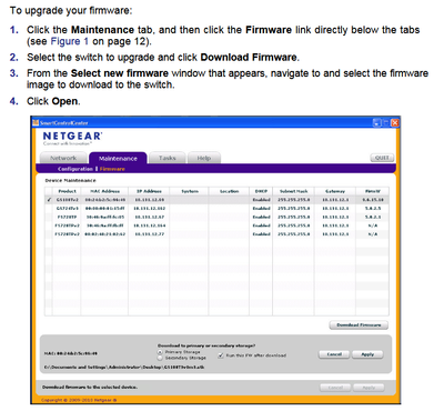

in The manual I found This:
With Web Gui I think you mean to log in to the Switch with IP
Pls help to fing Where to Update firmware
I have not seen it!
As I tried to find it i think I read somewhere that I schould use the Control Center.
SO What is realy the way to Update firmware?
