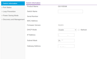

    • The latest firmware, attached is the screen capture. Same problem.
