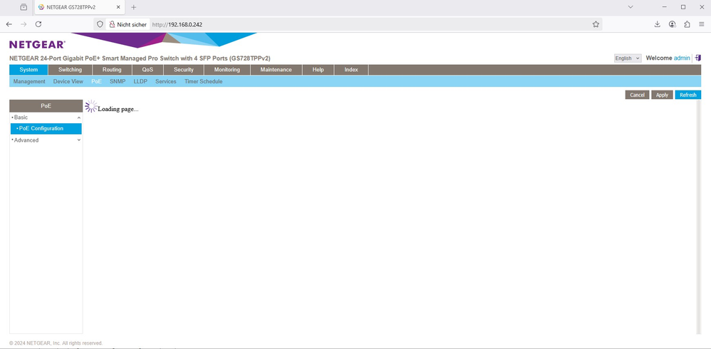

The interface seems to be constantly loading and doesn't respond even after updating the firmware. Currently, I'm using firmware version 6.0.10.23.
When I exported the tech support file, it included the message "Get PoE FW Failed! Please check PoE HW."
Has anyone else encountered this problem? Any insights or suggestions would be greatly appreciated!

    The standard reason for such effects like the "Loading Page" is a hardware issue, where the PoE controller is no longer workable (read defect!), probably doesn't allow to provide PoE power to the ports.
    Worth a try is flashing the current firmware again lnc finished, followed by the required cold reboot, and see...
    Head to https://my.netgear.com/  and file a harder issue report. Nothing the community can do for you here I'm afraid.

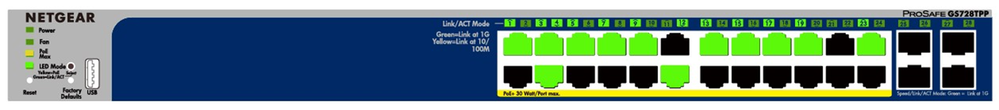

      Hi Kurt, thanks for your insight. I also suspect that it might be a hardware failure. However, all the PoE-powered cameras seem to be working normally except for the one on port 13. Is there anything else I can do to debug the issue besides physically disconnecting the camera? In the meantime I will also seek advice from technical support.

    Happens with a different browser?

      Thanks for the quick response, the switch is located on a frame eight metres high, which makes it difficult for me to access. I've tried using different browsers, but nothing has changed.
      Initially, there was a PoE-powered camera that kept disconnecting. Upon investigation, I found that the link speed was only 100 Mbps. When I opened the settings, I saw a 'PoE Max' warning. That's why I want to look into the PoE settings, maybe they're connected.
