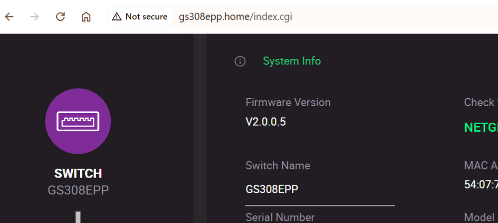

Afraid, I don't own an MS305E (nor a MS308E), so can't compare. On the GS308EPP, defining the device name does not make a difference, it can be reached and accessed using the password either way.

This DNS name is served by the ISP router LAN btw. - works like using the pure lan IP address.
