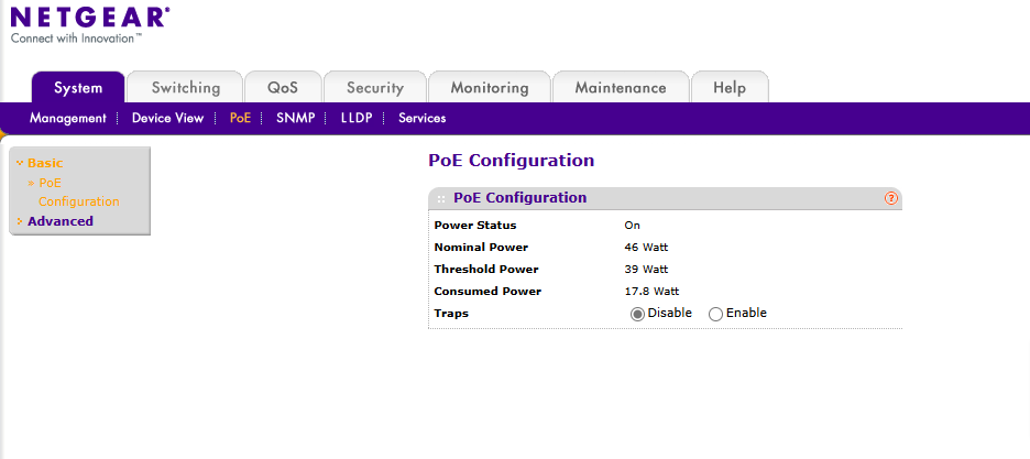

I have had this managed switch for many years. Now it is used to supply POE for a number of CCTV cameras only. The typical power usage....

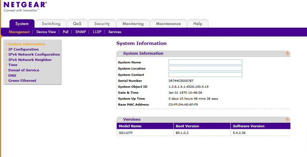

can be seen above. The software / firmware used....
