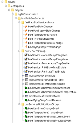

        In fastpath_boxservices.my I cant find any FiberPortsOpticsTable
        Switch itself told me that they will support the following MIBs:

        Looking futher through MIBs until I found it and will report here 😉
