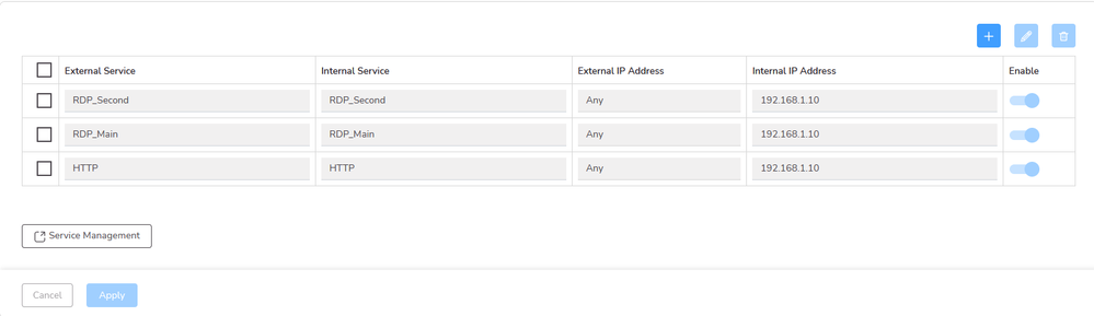

        As for how I did the port forwarding on the PR60X, I didn't need to specify which WAN ports it would apply to, I just made sure that External IP Address was set to "Any". First, you need to make a new rule under Service Management that specifies the ports.
        Once they are added (or if you want to use one of the pre-defined ones), then you can go to the Port Forwarding page and they will appear in a list of rules when you add a new entry:
        I have never used the predefined ones myself, so I was never able to check if port 80 had the issue like you mentioned.
        As for why I have two RDP ports connected to the same internal IP, it's because that device is my Netgear RS700 router, which I have all of my computers hooked up to. I know that I am in a double NAT situation, but I don't mind this setup since I am still able to set up a VLAN through the PR60X so I have the RS700 dedicated for my main network and another router that is used for my Guest and IoT WiFi.
  • FWIW, I tested out this port by installing an Apache web server on my Raspberry Pi. First, I port forwarded port 80 to my RS700 to verify that worked by logging into the IP as seen from the PR60X's side (192.168.1.10). Then I forwarded the same port as shown below:
    I am able to access this the Apache test page on both my main IP address and secondary IP address (when failover occurs).
