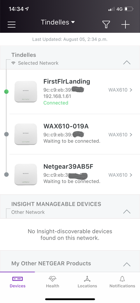

Hi there - 3 x WAX610s have worked faultlessly since Nov 20, but in the past few days, despite no changes to the network, we've seen these devices disconnecting at random times. My plan was to factory reset all the units. I started with the extenders (leaving the root device FirstFlrLanding alone), I performed a factory reset on both extenders, but now they won't/don't connect to the selected network (see image) I've checked, and all devices are on the latest firmware. Any suggestions?  Each unit is powered with a mains adapter (not PoE).

    The root device is working as expected, but having reset 2 extenders (due to repeated disconnection issues), I can 'claim' the reset devives, but they then fail to connect - this is what the cloud logs on one of these devices reports:
    curl_easy_perform(url='https://registration.ngxcld.com/registration/register') failed with error code 60: 'Error'.
    2020-03-03 01:01:34 (18521):logic.c:405 ERROR: Can't' make register request.
    2020-03-03 01:01:34 (18521):xagent.c:289 WARNING: Failed to register device.
    2020-03-03 01:01:34 (18521):xagent.c:297 WARNING: Sleeping for 10 secs.
    2021-08-07 10:33:13 (18521):xagent.c:309 INFO: Device is registered successfully: id='3EGZHT68-3110-335-190034104', hardwareId='6AC40A230019A', claimCode='GPQZ5AB8GEWB2M3F0'.
  • Raghu davys Thanks for your help - the bizarre solution (as suggested by @davys) was to change the secondary DNS settings on the root device from the gateway (192.168.1.1) to 8.8.8.8. Once I'd done this I perfomed another reset on the WAX610 extenders then claimed them through the insight cloud interface - both extenders then connected and appear to be working fine.
