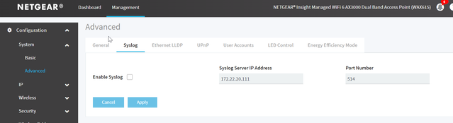

    I've tested this with an WAX615 (FW version 10.3.1.8 old version, now we're at version 10.4.1.7), setup Syslog, then rebooted the AP:
    Then, disabled syslog, and rebooted:
    It shows the details again, but it doesn't show as enabled.

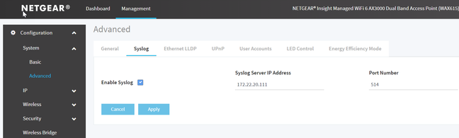

      • AP is upgraded to latest FW 10.4.1.7.
      • Enabled syslog, and rebooted.
      • Disabled syslog, and rebooted.
      • And, syslog is re-enabled:
      I'll log a bug with the engineering team, to get this adjusted/resolved.

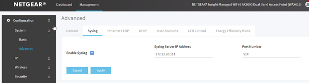

        I tried to downgrade to version 10.3.1.8 again.
        Setup syslog, and rebooted.
        Disabled syslog, and rebooted...
        Unfortunately, it's enabled after coming back up..
        I'll report back once I hear from the engineering team.
