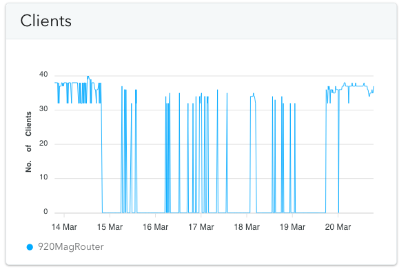

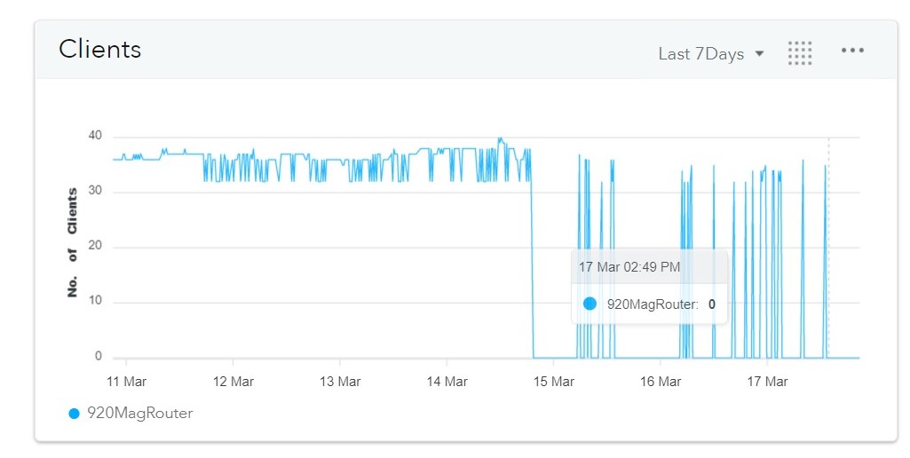

  • I'm having problems since firmware version 2.6.2.200 was automatically updated. It would stop connecting to the internet and the router would light magenta.
    Notice the attached chart that everything was working great until my router firmware was updated! PLEASE FIX THIS ISSUE!!!!
    I tried downgrading but the web client does not allow me to do this. Also the web client has disabled the ability to disable the automatic updates. WHY!!!!

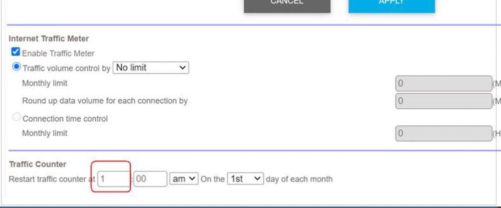

      I've finally have some stability since I made the change to 1 am due to daylight savings bug!!!!
      Didn't your test cases account for daylight savings?
