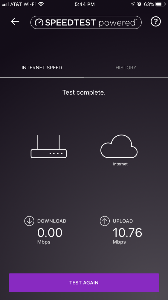

Nighthawk App Speed test is not working properly
The NIGHTHAWK APP Speedtest is not working properly on my iPhone 8 Plus. The download speeds are 0.00 upload speeds are ok. When I take a speedtest using OoklNIGHTHAWK APP SPEED TEST RESULTSNIGHTHAWK APP SPEED TEST HISTORYa, etc my internet speed is fine... download 86+ Mbps upload 11 Mbps...
Is anyone else experiencing issues with their app?

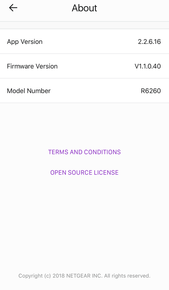

The speed test is run on the router, not on the mobile device - the App is just the controller, reading and displaying the test results and the history from the router. Unless all Nighthawk App on iOS show the 0.00 on the download side (there would be more reports) this looks more like an interoperability problem with the router model/firmware. In the App, go to the Main/Home menu and select -> About. Provide exact router model, router firmware, and App version (or an About screenshot) so Netgear can investigate.
AC1600 Smart Wifi Router Product R6260...this is removed from the choices above so I had to manually input this...maybe many people are having issues with this model????
NIGHTHAWK ROUTER INFO...

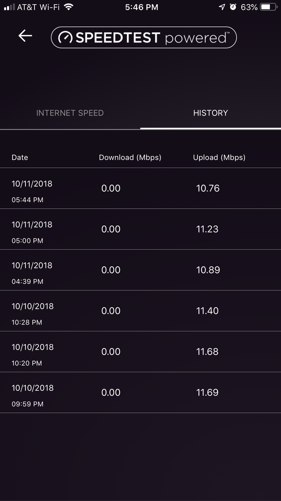

Same, but different router model R6900 (as per the tag), firmware version, ... and confirm you get zeros in the History tab for the download side, too?

Hardware: R7450
Firmware: 1.2.0.32- tontod1Aspirant
Same model (R7450) and firmware (1.2.0.32) having the issue with me. Seems like widespread issue to me

- DexterJBNETGEAR Moderator
Hi all,
Latest update from engineering is that the fix will be available on the next firmware release for the affected models. Please make sure that your device firmware is up to date if you haven't checked yet.
Dexter
