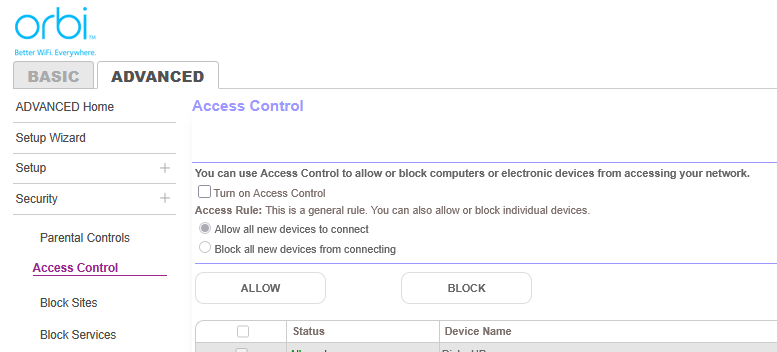

    Might be a good idea to double check the Access Control settings...
    Is Access Control enabled?
    Does the printer show up in this table with a status of "Allowed"?
  • CrimpOn's avatar
    CrimpOn
    "accessing your network" is a bit of a delicate subject (splitting hairs).  There is no method to prevent a device from connecting:
    • A device with an Ethernet port can be plugged in.
    • A WiFi device that presents the correct password will be connected to WiFi.
    • Both will be assigned IP addresses.
    What is blocked is the ability to communicate through the router or satellite.
