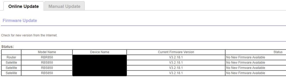

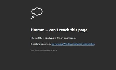

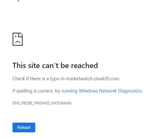

- EruJaminAspirant
I have this issue across all my devices after upgrading to the Orbi WiFi 6 system. I get the DNS PROBE FINISHED NXDOMAIN error and the site either eventually comes up or times out. My Orbi WiFi 5 system never had this issue and nothing has changed except swapping out the routers.
EruJamin wrote:I have this issue across all my devices after upgrading to the Orbi WiFi 6 system. I get the DNS PROBE FINISHED NXDOMAIN error and the site either eventually comes up or times out. My Orbi WiFi 5 system never had this issue and nothing has changed except swapping out the routers.
- EruJaminAspirant
I posted screenshots but they are not showing for some reason
I swapped out my Orbi 5 setup with this system last week and the issue started.
Model Name
RBK853
RBS850 (Additional Satellite)
Firmware
V3.2.18.1
Says no new firmware available when I do online lookup
Noticed you seem to be running a newer version V3.2.18.223
Frontier FIOS Fiber 1gb / 1gb Plan
Router Model
Arrus NVG468MQ
I do not use the provider modem as it is not required with Frontier. I tested with and without it and still had same issue.
I have also tested using different DNS services like CloudFlare and Google Public DNS
