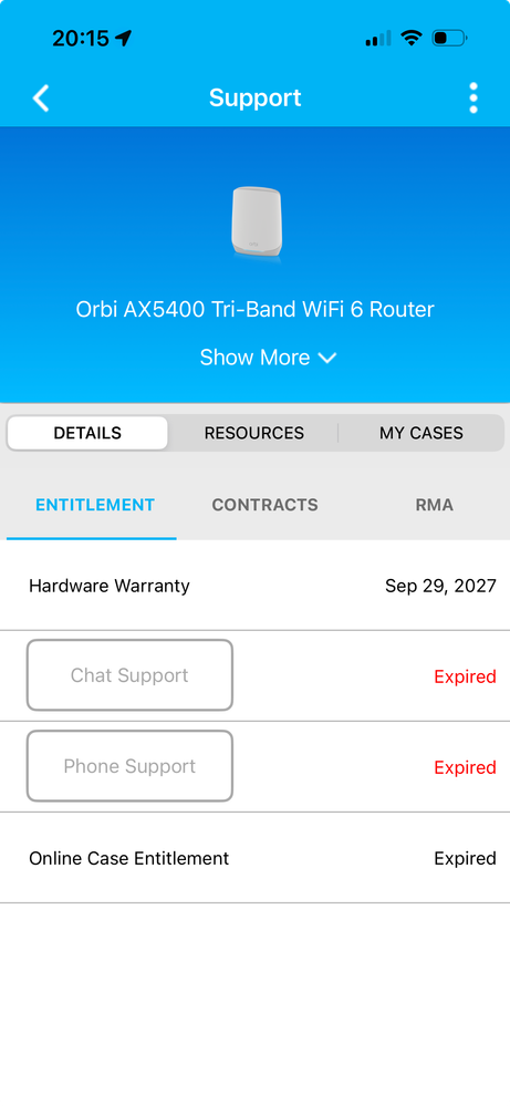

  • Looks like all my support options have expired while they were they were taking their time not finding a solution to the SPC issue. Any suggestions on how get a new case going? Or re-opening the previous SPC case number 49727343? In which I also mentioned this loss of config issue multiple times....

  • Where did the text "Any updates, please update your support case regarding this." come from?
    Anyway, I cannot update a closed case. And I cannot open a new case, because my 'Online Case Entitlement' has expired...
    • FURRYe38's avatar
      You'll have to get in contact with NG support and ask if they can reopen your case.
