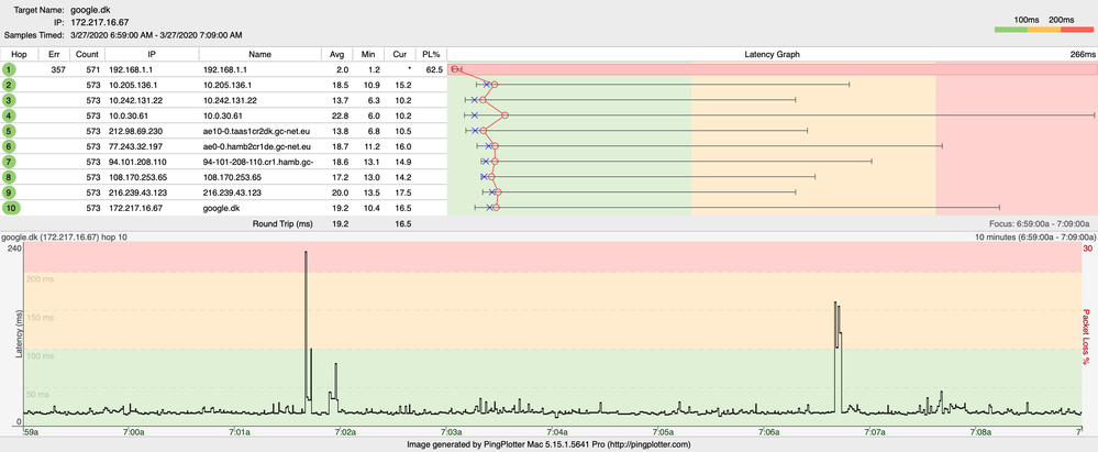

      Still having these issues.
      This is me trying to traceroute and ping Google
      • FURRYe38's avatar
        What are your results with a wired PC connected directly to the ISP modem?
        What is the Mfr and model# of the ISP modem the NG router is connected too?
