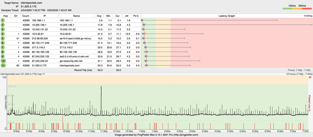

      Weirdly enough, I stumbled upon the realization that the system was not playing nicely with devices if they were set up using a static IP or with DHCP coming through another device, such as a home server. Using the router as DHCP cleared up a lot of my issues. But I was still dropping Pings approximately every 6.2 minutes on each WiFi band according to the PRTG Network Monitor I installed. The drops reduced a little bit when hardwired, but not by much.
      I again reset the RBR850. And this time it changed the CTS/RTS Threshold back to 64. I noticed at that level that my ping graphs leveled out somewhat. So instead of having huge peaks and valleys for response time, it started leveling out to a more consistent amount.
      Playing with it a little more, I tested lowering that threshold to 25, which I know is low. Now my pin times to the router are nearly consistent, only varying by about 1 ms on Wi-Fi. Since making these changes, I have had no connection drops at all. it has been logging for nearly 3 hours now and my connection seems to be stable.
