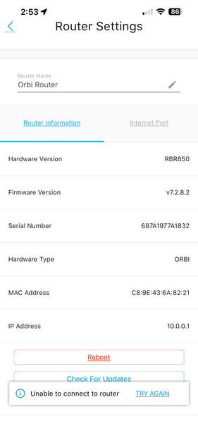

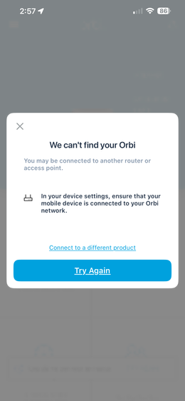

I opened the Orbi App (2.54.1.2) on my iPhone (iOS 26.6.1) to monitor some devices on my network and get the message "We can’t find your Orbi". My iPhone is connected to the WiFi SSID noted in my RBR850 Router.  I am not having any internet connectivity problems on the 30 some items connected to the same SSID WiFi network.  If I look in Network Map, My ATT Router and RBR850 Show as not connected, but my 1 RBS850 shows as connected. I note that my Router Settings show Firmware v7.2.8.2 but the latest version is v7.2.8.5.  I tried to manually upload the newer firmware but I can’t seem to connect to my Router login page (10.0.0.1).  Where do I go from here? I’ve had this system for 3 years and it has worked flawlessly, what could be wrong?  Thanks in Advance!

      Thank you FURRYe38.  Some more information:
      I have a ATT / Nokia BGW320-505 Router /Fiber Modem that recently replaced an 9 yr old router/Fiber Modem and it was operating just fine.
      I am connected to the Main Orbi WiFi Network.
      When I click the hamburger icon on the top left of the Orbi App, I see the the RBR is connected locally, but when I click on that it goes to a “My Products” Acreen that says: "No devices with Anywhere Access enabled. To enable, while connected to your routers WiFi, go to Menu > Settings > Anywhere Access within the App."
      When I try to navigate there in the App to "Enable Anywhere Access" it tells me to Check My Internet Connection.  The “switch” does not enable anywhere access. See additional screen shots.
