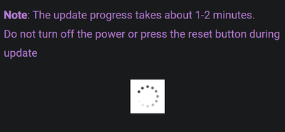

    • FURRYe38's avatar
      How does that file not work? How are you unpacking the file and sending it to the RBS? That is the RBS file.
      Mythicque wrote:
      This is what the zip contains for me which doesn't work.
      • Mythicque's avatar
        Mythicque
        I extract the zip, go to orbi web page, go to manual update, select 1 satellite, select that file and upload it. But it gets stuck infinitely on the page in the screenshot.
