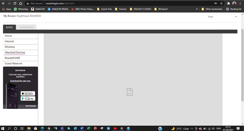

Nighthawk RAXE500 - After latest firmware update v1.0.7.68_2.0.35
Hey Guys,
After latest up to firmware v1.0.7.68_2.0.25 the option "Access Control" is broken. It can no longer be accessed. When attempting to access this option, it takes a long time loading to finally show a broken page as you can see in the picture attached. I tried different browsers to no avail and when you run the mouse over the little square face it says the following: "routerlogin.net didn’t send any data."

    I tried it on mine and had the same issue in edge, chrome, and vivaldi.

      Oh brother! It's a shame this is happening, I tried again today on all most popular browsers to no avail. netgear when are you going to address this issue. This is so annoying to say the least. So much for an flag-ship device like this one.

        Yes, I did the hard reset and factory reset twice to no avail at all. This issue estarted after the latest firmware update. It's also unable to block any device in the app as well. I did my homework before I came here. I have two of these devices with the same issue after the update. I'd really appreiciate your assistance here in reporting this. Feel free to contact me for more details.

        Hopefully they don't take long. Other menus inside the UI is shows yhe same error.

      I've updated to the .69 beta firmware and can confirm the access control issue has been fixed on mine.

      Hi Darren, thanks for looking into this! I am running the RAXE500 in Access Point mode so I do not believe Access Control presents itself in the Nighthawk app in this configuration. That said, the Access Control page in the Web UI fails to load as expected and seems to timeout as others have reported (same behavior in Firefox, Chrome, Edge, etc) This issue appears to have popped up with the latest firmware update as I was able to use Access control fine before that.

      For the web if you 'Turn on Access Control'. The access control list is no longer available and logs you out.
      For the iPhone app. The access control list can be accessed, but attempting to allow/disallow access gives an error.
