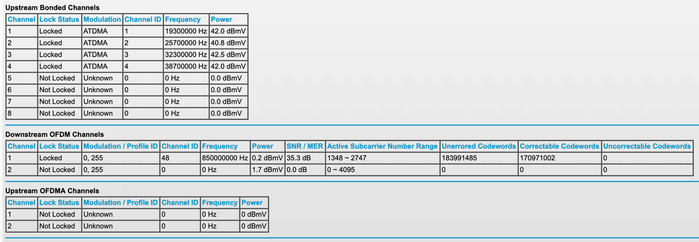

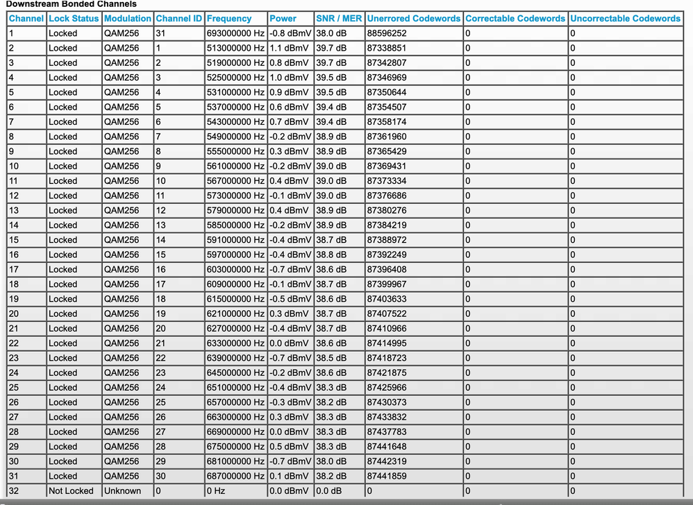

I recently changed my router to the RAX80 after my old router burned out. I was already using the Netgear CM1100 modem with XFinity for months and had no issues.
One thing I noticed after switching to the RAX80 is that internet connection would drop frequently sometimes every hour or so of usage. When looking at the internet port status, the IP lease through DHCP is valid for more than 2 days.
Whenever the internet drops, I try to look at the logs on the modem. When I try to connect to the modem to "http://192.168.100.1", I cannot connect at all and get a time out. This leads me to think whether RAX80 is somehow making my modem crash.
For me, the remedy is restarting the modem. Given that I've been using the CM1100 modem with XFinity reliably with my old modem, it's hard to reason that it is my modem or XFinity; I had trouble with the RAX80 on the first day of use.
I'm wondering whether anybody had the same issue before. If you have any insights, please let me know.
Thanks.
I've attached the cable connection info from my CM1100 modem just in case.
