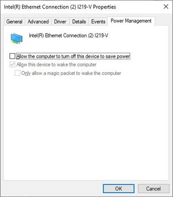

    On the PC, have you checked the properties of your Ethernet hardware to see if Windows is putting it to sleep under the power plan?

    Oh, and ensure that the PC isn't set to turn off the LAN connection to save power.

    PC's ethernet is not put to sleep as part of a power plan.  It's a desktop, and isn't setup that way.
    Even if it were, I wouldn't a PC reboot, or

      I have to ask, is this based on your experience or because you went to the Ethernet connection properties window and looked at the Power Management tab?

      This is slightly more reliable, but I have to agree with Kitsap . Did you actually check the setting? Windows can do unexpected things.
        There is no setting for that on this desktop PC.  I checked that before I posted here. Nothing under devices, networking, or power.

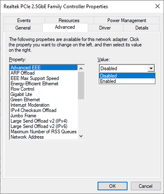

    • Razor512's avatar
      Razor512
      Prodigy
      Depending on the Ethernet cable used, if the resistance is too high, there can be some issues, especially if "Green Ethernet" or other advanced EEE is enabled.
      Since many Netgear routers support a wide range of those power saving functions, if an Ethernet cable is borderline in maintaining connectivity, and both the NIC and router can use them, it could lead to issues, assuming there is no other more basic issue such as a DHCP conflict assigning the same IP to 2 separate systems, which can lead to windows not being able to communicate, and then eventually give up.
      For DHCP conflicts, one potential solution, is to go to the LAN setup in Advanced > Setup > LAN Setup, and assign a different IP to the desktop PC.
      If it keeps happening, it may be worth doing a factory reset on the router, especially if anything like an old config backup from a different firmware version is restored.
      • davidji's avatar
        davidji
        Thanks. I switched off Green Ethernet on the PC. I'll see if it helps.
