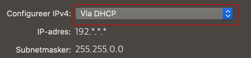

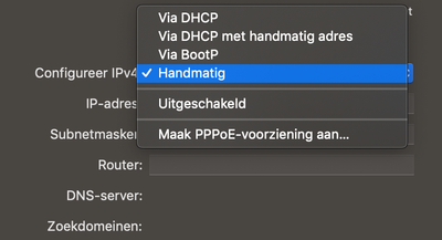

Open up your network preferences and use the admin rights to unlock your configuration settings.
When you connected your USB network adapter and cable you will see that your MacBook will self-assign an ip-address which probably will start 192.169.*.* or 169.*.*.* and an exclamation mark that there is no internet connection. It will look roughly like this.
In the red dropdown is where we are going to make some changes: Clicking on it opens up the following choices:

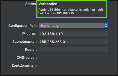

At this point we will be starting to assign a manual ipadres to our Mac to we need to choose Manual (Handmatig). When you choose manual you have to fill in the following data
IP-adres:
192.168.1.10
Subnetmask:
255.255.255.0
Router:
Leave empty.
The result will be that the USB Network dongle will directly connect with the router and if succesful it should will also state that it's connected. The reason why do manually assign an ip-adres to make sure that your Mac doesn't get the same ip-adres as the host/router. If everything went ok you will get the following screen:
Status: Connected (Verbonden)
Apple USB Ether wil get the assigned ip-adres that you have given in, in this case 192.168.1.10

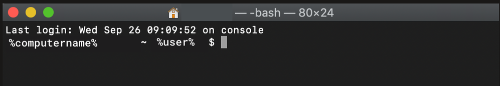

First we define where we are, normally you are in your home directory. type the following command:
ls
You will see an overview of you home folder including a directory desktop. We will navigate towards that directory using the following commando:
cd Desktop

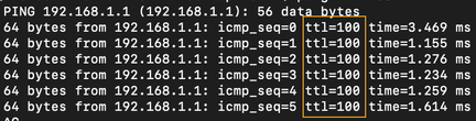

ping 192.168.1.1
If succesful the results will look like this:
The orange part is where you need to look to see if the router is in the right state to upload the firmware manually. ttl=100 is the state that worked for me.

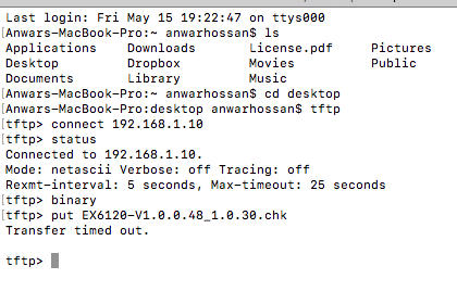

In terminal type the following code:
tftp
You will see that your computername and user are gone and will be replaced by tftp. First we are going to connect to our router using the following :
connect 192.168.1.1
When succesful nothing happens and you will be shown a new tftp line. To make sure we have the right settings to upload the file you use the following command:
status
This will display the current status of the router:
To use the transfer we need to set the mode to binary otherwise it will not accept the file. This is where I struggled for more then a two hours to find this. Changing the mode to binary every step after that worked. To change the mode type:
binary
You can if the change worked by using status, when succesful you will see mode: octet.
Now we will upload the file to the router by using the following commando:
put R7000-V1.0.9.34_10.2.36.chk
Remember to replace all the version number to the version you are uploading.
This will take some time, when I was uploading it took me around the 110 seconds to complete. You will get a notification when it's done. From this point you will see your router rebooting and a lot of lights flashing and starting your router. It may take up to roughly 7 minutes to fully reboot and install etc.

For me the method still does not work, because in Step 3, ping returns mostly
Request timeout for icmp_seq xx
without the
ttl=100

Everything was going as you clearly stated right up to "put R7000....." . The file could not be found. The file is on my desktop, it is unzipped. What am I doing wrong? Help.
- myerswMaster
If you are following directions and using windows tftp you need to be in the directory where the firmware is stored. Otherwise the tftp client cannot find it. So make sure directory you are in has the file.
I am using a Mac - not Windows. Am I missing something? I checked for the file as instructed by checking the desktop files in the terminal app.
