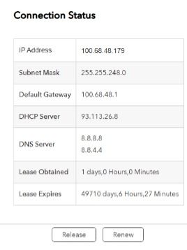

I have a Nighthawk RS700 currently running firmware 1.0.9.16. There is a problem with renewing the IPv4 lease. If I restart the router it picks up an Ipv4 address with a 24 hour lease. After 12 hours it should release and then renew that lease for another 12 hours. However, instead of doing this, it retains this lease for the full 24 hours, at which time it does, then release and renew the lease and this is where the problem happens.

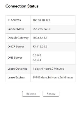

When it renews the lease, it shows the Lease Obtained as 1 Days, 0 Hours 0 Minutes and below that it shows Lease Expires as 49710 Days, 6 hours, 27 Minutes (first picture). Some hours later all IPv4 traffic stops (second picture).
All the lights on the router remain white and the Ipv4 Lease Expires display continues to count down, but most websites can no longer be reached. The only websites that continue to work are those with an IPv6 address, such as Google, Amazon etc. Sometimes it is possible to renew the lease by using the Release and Renew buttons, sometimes you cannot log into the router at all, and the only option is a hard reset.
