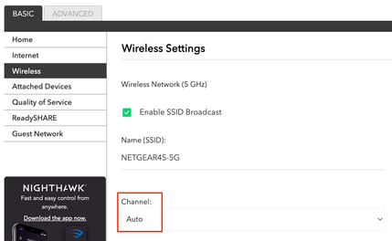

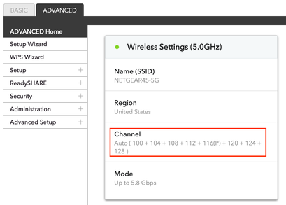

    From the router's management Web GUI,
    • BASIC tab / Wireless menu: Wireless Settings | Channel under the 5GHz --> it shows the operation channel set for the 5GHz band.
    • ADVANCED dashboard / Wireless Settings (5.0GHz) tile --> the Channel there shows the actual channel currently the 5Ghz is operating on.
