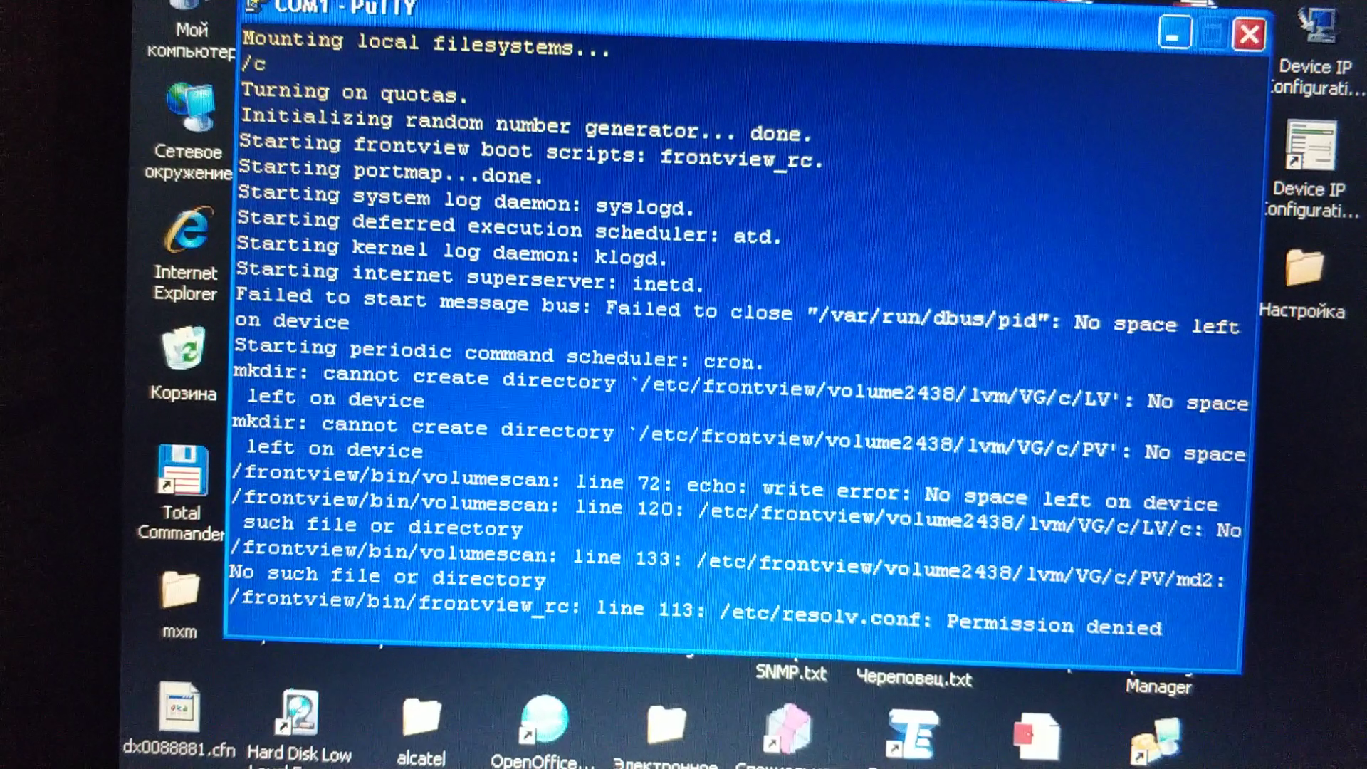

Hello. There was a problem that the web interface does not save the changes made (for example, does not even change the date and time). When connecting through the console via the COM port, even authorization under the admin user does not pass, I enter the login and password, but login to the terminal does not occur. There is a suspicion of an overflow of the system partition. Help me please! How to recover without losing stored data.

Thank you very much, everything worked out. The free space is occupied by the proftpd.log file.
