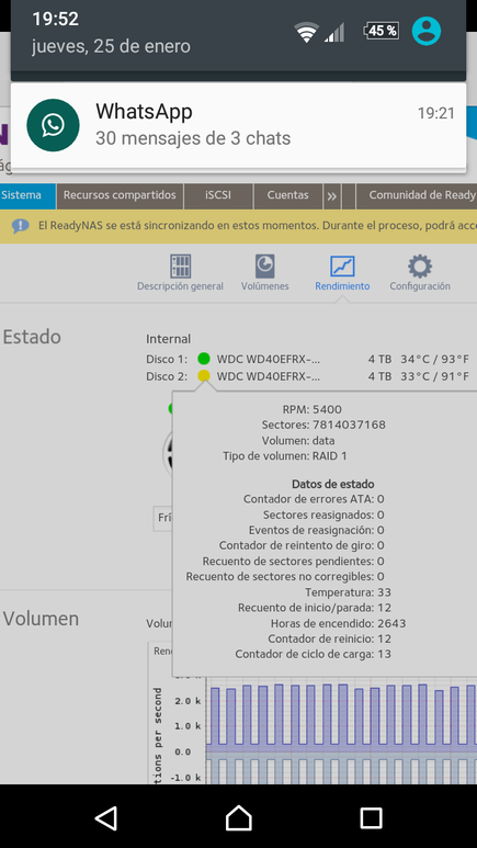

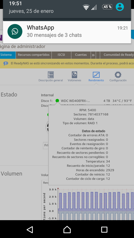

      To leave a record here, when I transferred the information when installing OS6 it was approximately 6 days the first hard disk running without the other, to fill the volume and force a resynchronization.
      That is to say, on January 25, 2017 at 7:52 pm, when I inserted the second hard disk, the statistics of the disk are:
      / dev / sda: 2929 hours
      / dev / sdb: 2643 hours
      From that moment on they will be 24 hours continuously, so that the SMART hour counters of both disks should increase correctly in the future (if these counters are lower than these values ​​in the future it is definitely a SMART error that the WD tool is not able to notify).
