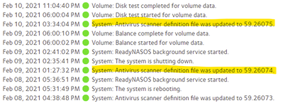

      The AV has updated twice since TestDatabases=false is set in my /etc/freshclam.conf.
      Not conclusive that the problem has resolved, just positive progress

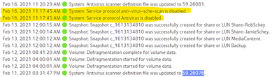

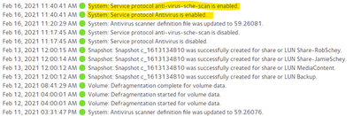

        I checked again today (Feb 16) and the AV has not updated fince Feb 11 so sadly the change TestDatabases=false setting in my /etc/freshclam.conf has failed to rectify or workaround the issue as seen in the log below
        I ran freshclam -v which ran successfully and my AV updated to 59.26081 from 59.26076 though there are some interesting messages highlighted below
        Freshclam seems to have disabled the AV and did not re-enable it.  This has not happened in the past.  Any thoughts?
        I manually enabled AV successfully as noted belowNow back to the successful running of Freshclam.  These details are noted below.  Nothing unusual execpt for the warning in red text at the end.
