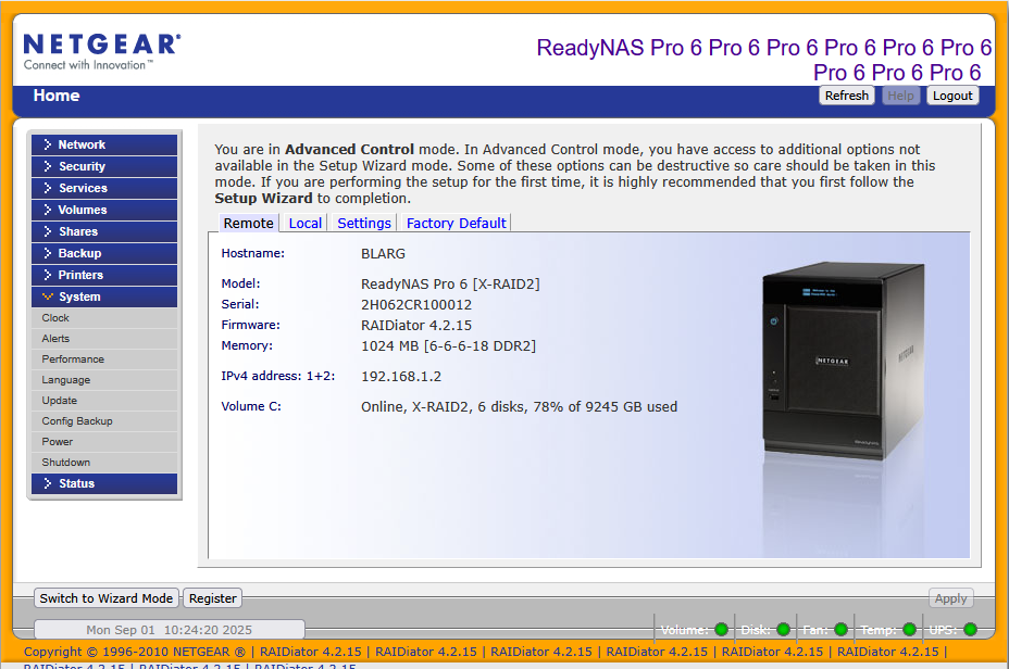

  • Here is the screenshot of the CP:
    Re: the RAIDIATOR update:
    Apologies in advance if this question is stupid-
    Do I need a version of RAIDiator installed on the PC I'm using to control the NAS? The firmware update unpacks as a .31 file.
    Endless thanks.

      • hellwiththis's avatar
        hellwiththis
        Sorry to say that clicking on Update does nothing. The main part of the screen does not change. If I click on the Local tab nothing changes.
        Here is a screenshot after I tried System/Update several times:
        Notice the repetition of 'Pro6' in the top right corner.
        Am I toast?

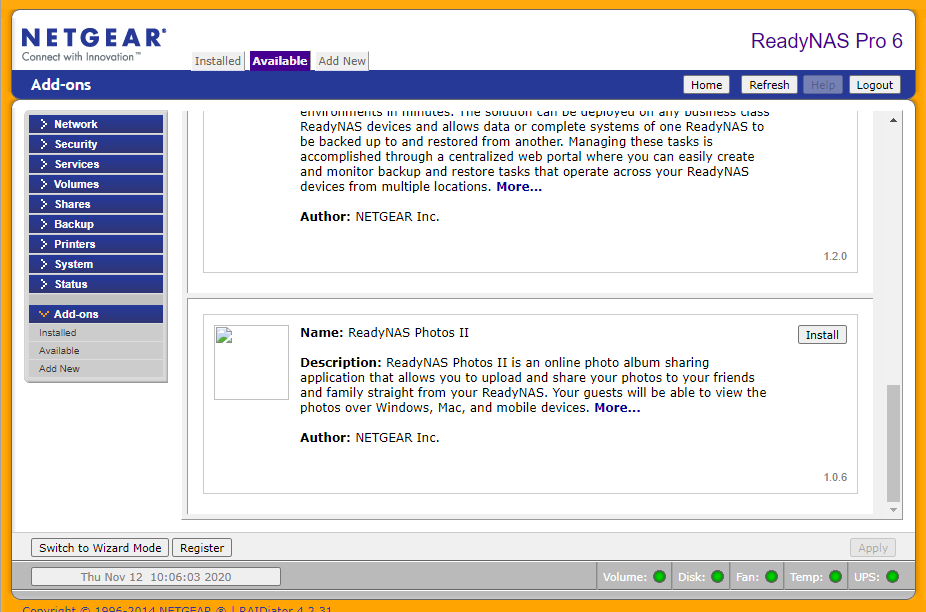

  • Thanks, StephenB, that is working.
    I can reach the NAS through the network (if I type it in; it still doesn't show up in the network window)
    and I can access the control panel.
    I downloaded the .bin file from github but I have no idea how to install the update. Can you nudge me in the right direction? Many thanks.
    • StephenB's avatar
      StephenB
      Go to this screen and click on "add new".
