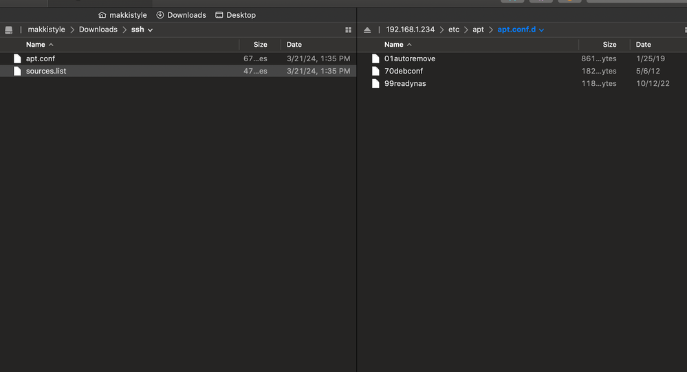

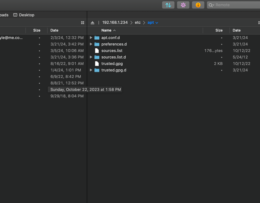

I loged in and this what shows me :
but the file you mentioned ( apt.conf )
where.i should copy it ?
here is a look in the folder apt.conf.d :
- SandsharkSensei
As stated in the very first message of the thread "Then you need to create /etc/apt/apt.conf with the following content:" So you put it in /etc/apt.

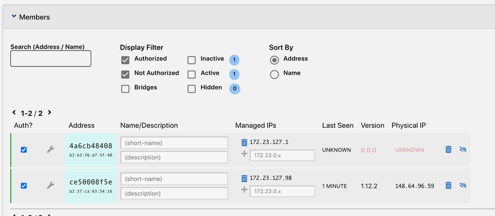

- dhlLuminary
Hi All,
Recently ZeroTier suddenly stopped working for us. I checked the ZeroTier network and it appears that our ReadyNas is not connecting. Here's a screen shot:The top address is the ReadyNAS, the bottom address is my connected computer. As you can see, the ReadyNAS doesn't have an IP on the network.
I ran zerotier-cli join in terminal with the network ID and received a 200 OK reply
But when I run zerotier-cli info I get an OFFLINE reply even though the ReeadyNAS is authorized.Sandshark, StephenB and anyone else - have you encountered this problem? What do I need to do to get ZeroTier back up and running? I'm using version 1.6.6

- SandsharkSensei
What model NAS is this on? I had a similar issue when both of my Ethernet ports were enabled and the primary one didn't have internet access. I have my primary and backup NAS's connected to just each other via a switch and static IP's, but the primary had ETH1 connected to my "real" LAN and ETH0 to the local-only one where the backups had the opposite. Swapping the ports (including their DHCP options) and re-booting the NAS did the trick. If your are using ETH1 as your primary network connection and ETH0 is enabled, even though not connected to anything, perhaps the same thing could happen.
