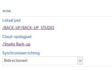

I setup OneDrive sync like this:
The local back-up data is on my EDA500. I wonder if that has something to do with it?

    The problem support was referring to is clearly on the BACK-UP volume.
    You have a BACK-UP_STUDIO_PROJECTS share but you moved that subvolume under BACK-UP_STUDIO. Similarly for BACK-UP_ACAPELLAS and BACK-UP_SAMPLES. That's where you went wrong.
    The snapshots subvolume isn't the issue.
    You could do e.g. (note don't copy the #, that's just to prevent blind copy and paste, always think about the commands you're entering):
    # mv /BACK-UP/BACK-UP_STUDIO/BACK-UP_STUDIO_PROJECTS /BACK-UP/BACK-UP_STUDIO_PROJECTS

    I can confirm it's all working now :)
    After recreating the Back-up share and setting up my Back-up locations differently, all files and folders are now synced to OneDrive.
