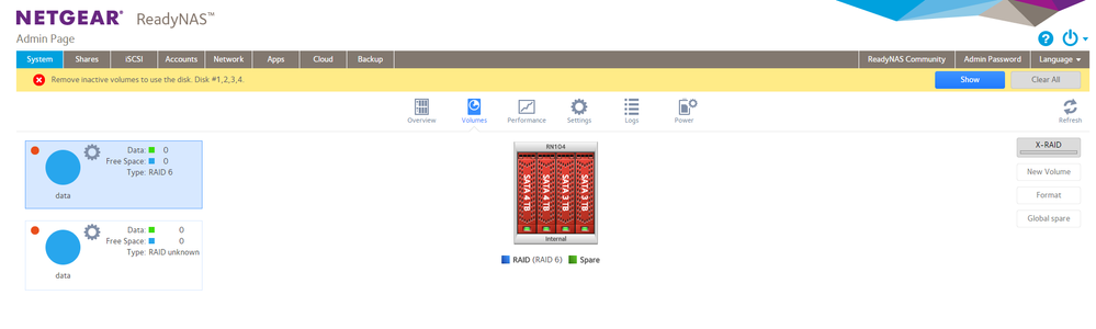

The resyncing process just finished and the drives remain red. I'm attaching a picture, it shows my RAID-6 volume and another unknown volume that I don't know what is. When I put the mouse over my RAID 6 volume, a popup appears saying "Remove inactive volumes to use the disk. Disk #1,2,3,4". This is also shown as those yellow messages that appear in any screen.

I can't see the screenshot as it wasn't approved yet.
Download the logs from the GUI, search for md127 in dmesg.log and paste an extract here.

The NAS is generating a lot of logs, I'm attaching an screenshot of it.
