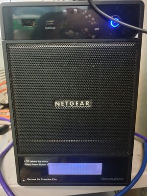

I'm not an IT person: this will likely show in a way I'm talking about the issue. ;-) Our ReadyNAS started rebooting every day for the past few weeks. I thought cleaning the dust would help. As it wasn't doing anything I switched it off from the cable not using the back ON/OFF. Worsened the issue. I tried the reset button at the back using the NORMAL rebooting: became a loop "Checking FS". I wanted to do an OS reinstall but how do you confirm that choice on the menu: I tried the press and release button at the back but it's not working. Any video where I checked what I should be doing?55Views0likes1CommentReady Nas 314 Firm 6.10.10 Raid Inactive
