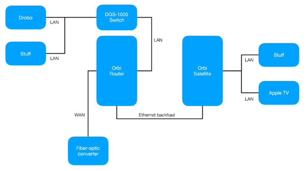

However, I recently implemented Ethernet backhaul and suddenly Infuse Pro on my Apple TV would stop in the middle of playing video stored on my Drobo every 10-20 minutes.

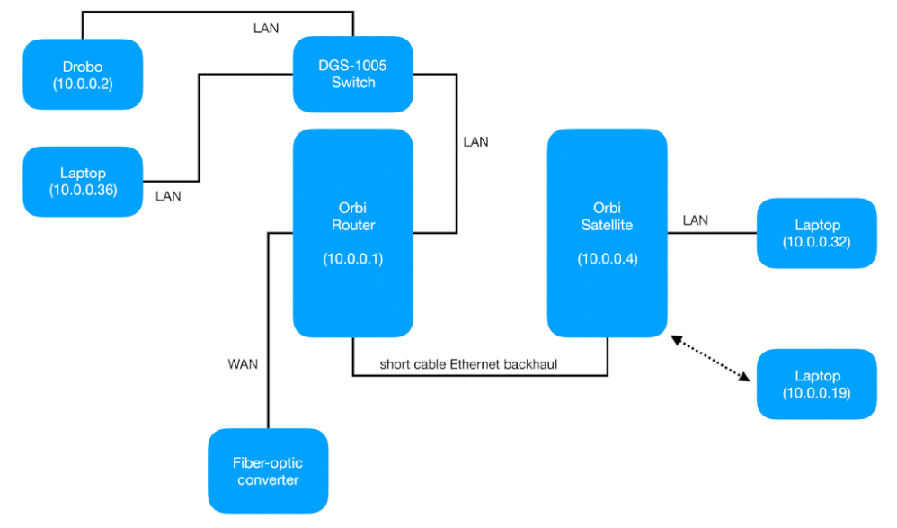

This was my original setup:
After some initial testing I concluded there were massive amounts of packet loss (some tests up to 30%) happening somewhere.

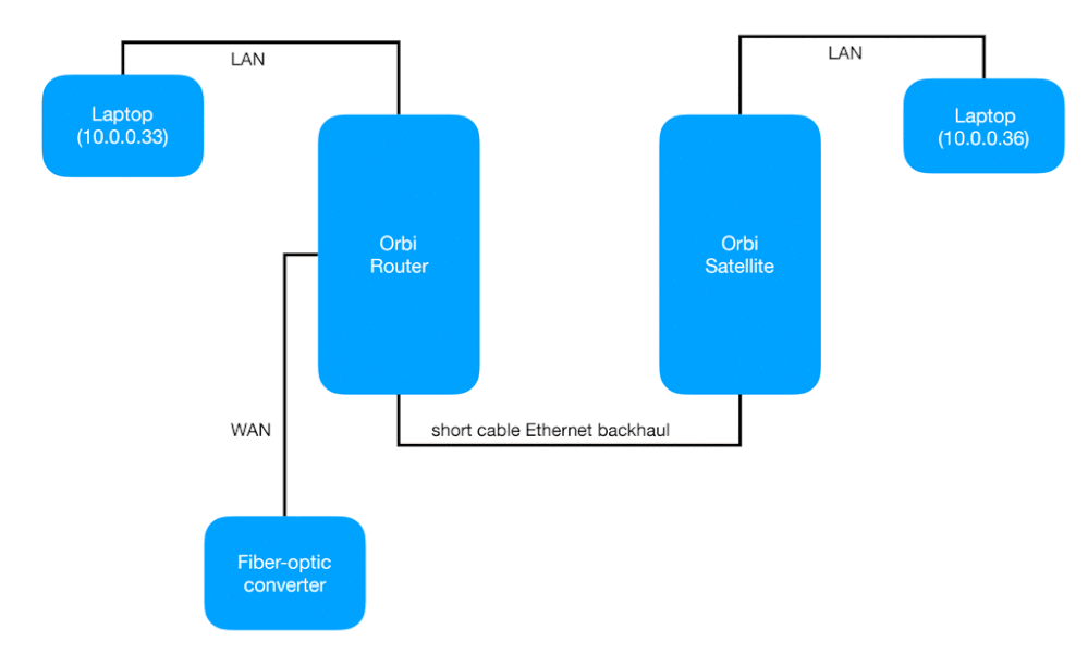

I can detail all the things I tried to narrow the issue down to the Ethernet backhaul if it is interesting, but I finally ended up trying the most basic setup I could imagine:
Both laptops have wifi disabled.
I still see massive packet loss between the two laptops, and also from a device connected to wifi through the router to the laptop wired to the satellite:

I have unchecked "Enable Daisy-Chain Topology", no difference.
I have applied new firmwares as they have been released, currently both are at V2.2.1.21.
If I unplug the Ethernet backhaul cable (which I have replaced with a short high-quality Cat 6 cable for the test) and restart the satellite and wait for the 5G backhaul to be established I can ping both 10.0.0.33 and 10.0.0.36 with little or no packet loss from the wifi, and zero loss between the two wired laptop wired laptops.
--- 10.0.0.36 ping statistics ---
2078 packets transmitted, 2078 packets received, 0.0% packet loss
round-trip min/avg/max/stddev = 1.651/3.443/23.380/1.186 ms
Ping statistics for 10.0.0.33:
Packets: Sent = 2075, Received = 2075, Lost = 0 (0% loss),
Approximate round trip times in milli-seconds:
Minimum = 1ms, Maximum = 13ms, Average = 2ms
I can't think of any other explanation other than that the Ethernet backhaul is at fault. I've tried multiple devices connected in different ways and multiple cables connected to different ports.
Simply disconnecting the Ethernet backhaul and leaving everything else the same greatly alleviates the problem.
However, I really want to use Ethernet backhaul as it decreases my latency for the Nintendo switch (included in the "Stuff" normally wired to the satellite) by 20-40%.
Any suggestions?

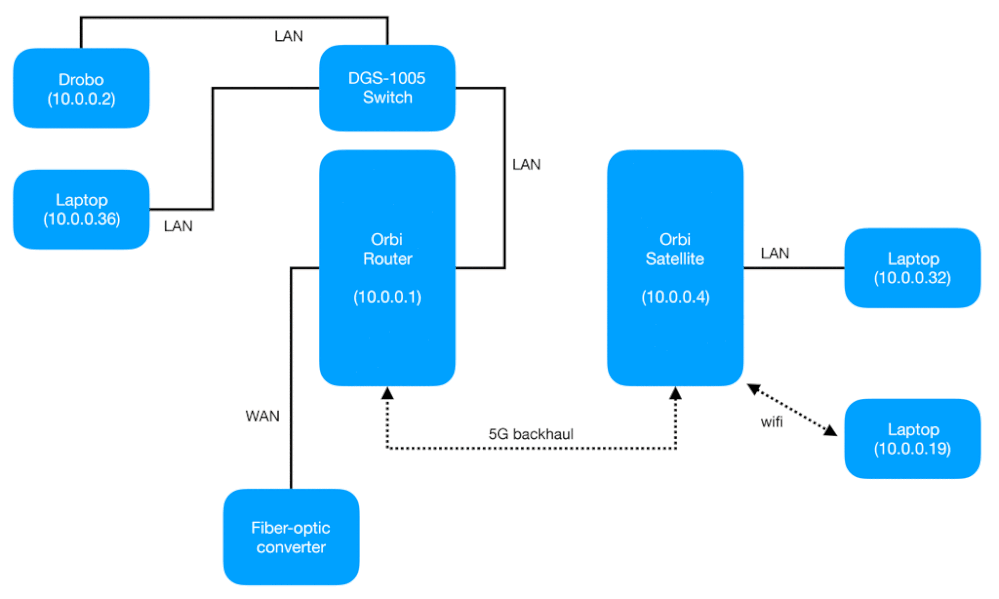

        So, here's the test I tried this evening. I started with 5G backhaul:
        From the laptop (10.0.0.19) connected to the router through wifi with 5G backhaul:
        10000 packets transmitted, 9999 packets received, 0.0% packet loss
        round-trip min/avg/max/stddev = 2.493/7.358/251.367/9.624 ms
        --- 10.0.0.33 ping statistics ---
        10000 packets transmitted, 10000 packets received, 0.0% packet loss
        round-trip min/avg/max/stddev = 1.029/4.328/317.584/8.420 ms
        --- 10.0.0.2 ping statistics ---
        round-trip min/avg/max/stddev = 2.134/7.446/793.257/19.222 ms
        From the laptop (10.0.0.33) Ethernet-wired to the router with 5G backhaul:
        9080 packets transmitted, 9080 packets received, 0.0% packet loss
        round-trip min/avg/max/stddev = 0.494/3.844/1796.147/21.845 ms
        9083 packets transmitted, 9083 packets received, 0.0% packet loss
        round-trip min/avg/max/stddev = 1.181/3.478/1953.779/21.589 ms
        From the laptop (10.0.0.36) Ethernet-wired to the satellite through a switch with 5G backhaul:
        Ping statistics for 10.0.0.1:
        Packets: Sent = 10000, Received = 10000, Lost = 0 (0% loss),
        Minimum = 0ms, Maximum = 282ms, Average = 0ms
        Ping statistics for 10.0.0.2:
        Minimum = 0ms, Maximum = 1ms, Average = 0ms
        Packets: Sent = 10000, Received = 9883, Lost = 117 (1% loss),
        Minimum = 0ms, Maximum = 17ms, Average = 0ms
        I then connected the Ethernet backhaul cable:
        From the laptop (10.0.0.19) connected to the router through wifi with Ethernet backhaul:
        -- 10.0.0.1 ping statistics ---
        round-trip min/avg/max/stddev = 0.856/3.826/375.312/8.331 ms
        10000 packets transmitted, 9491 packets received, 5.1% packet loss
        round-trip min/avg/max/stddev = 1.011/4.137/375.312/9.731 ms
        --- 10.0.0.4 ping statistics ---
        10000 packets transmitted, 9989 packets received, 0.1% packet loss
        round-trip min/avg/max/stddev = 1.037/3.873/375.340/7.215 ms
        10000 packets transmitted, 9524 packets received, 4.8% packet loss
        round-trip min/avg/max/stddev = 1.038/4.202/504.643/11.575 ms
        From the laptop (10.0.0.33) Ethernet-wired to the router with Ethernet backhaul:
        --- 10.0.0.1 ping statistics ---
        10000 packets transmitted, 9588 packets received, 4.1% packet loss
        round-trip min/avg/max/stddev = 0.269/0.442/6.942/0.162 ms
        10000 packets transmitted, 9486 packets received, 5.1% packet loss
        round-trip min/avg/max/stddev = 0.242/0.362/1.081/0.053 ms
        10000 packets transmitted, 9564 packets received, 4.4% packet loss
        round-trip min/avg/max/stddev = 0.285/0.700/14.856/0.201 ms

    Of course the family at this point started to complain about loss of internet and I did not want to try again.
    What I concluded from this short test -together with my previous experience with Orbi- is the following:
    1. Orbi LAN ports are very sensitive to the wired devices connected to it
    2. This "sensitivity" is more evident when you have wired backhaul
    3. I should be cautious with devices that have wireless capability when using them as wired devices in Orbi, they can cause loops and system instability.
    At this point I'm not sure what made my Orbi unstable when I connected my laptop, is it the bad LAN port configuration, or the loops caused by combination of wired and wireless connections in the same device.
    I will try again later and see if I can simulate this case again. Meanwhile I have the following questions:
    • Do you have any static IP settings in your wired computers?
    • Are you sure that wireless is completely disabled in those computers
    • Does the same issue happen if you disconnect one of the computers (one at a time) and ping from the other computer to any other device (wired or wireless), repeat the the same with the other computer? It can be only one of the computers is causing this issue.
    • Is Daisy Chain Disabled? you mentioned that but please make sure it's unticked.
    Another test that I would like to do, at later stage, to avoid loops in backhaul, is to disable the wireless backhaul (with telnet commands) and see if this will do any improvement.
    • Mooose's avatar
      Mooose
      Luminary
      Thanks for looking into this!
      I believe I have never set any static IP addresses, and I am sure the two laptops used for the test received theirs through DHCP.
      I am certain macOS and Windows 10 on the two computers involved think wifi is disabled. I have also verified that they do not show up as wireless connected devices in the Orbi web interface.
      I have done similar tests with these two particular devices turned off, it was packet loss from the Drobo to the Apple TV that originally alerted me that something was wrong.
      I will try turning them off one at a time tomorrow and ping from the wifi laptop.
      Daisy Chain is disabled. (Or, unticked, at least.)
      I am surprised wireless backhaul cannot be easily disabled from the web interface.
