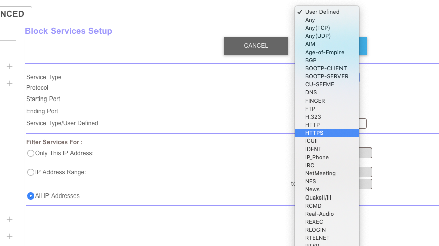

Orbi Blocking Websites - Solved
ORBI is blocking HTTPS websites that are not explicitly defined in URL.
To unblock any https website, do the following:
Log into to your router admin console (https://orbilogin.net)
Click on Advanced Tab
Click on Security >> Block Services
Click Add
Click on Service Type DropDown and Select HTTPS
Click Add to save
Your all set. Close out admin and then retry ORBI admin console as just orbilogin.net and waalaa.Add Https as unblocked service
Thank you. This fixed the same problem I was having as well!
