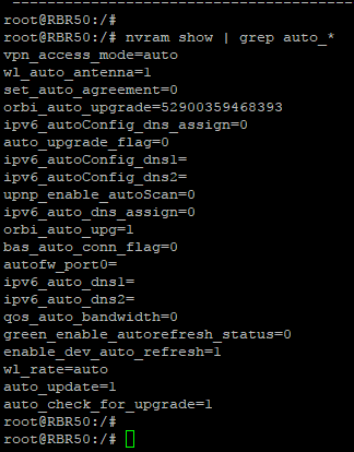

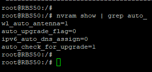

- orbirickApprentice
First time doing the telnet thing so I downloaded PuTTY for my Win 10 PC. According to the instructions here:
https://community.netgear.com/t5/Orbi/Firmware-V1-12-0-18-Discussion/td-p/1320421/page/5
I should be seeing a different auto_upgrade flag. Instead of a '1', I see a '0', the one it should be changed to, per the instructions.
The auto_check_for_upgrade=1 shows the same as the instructions, so I'll change that. Other than that 1 change, is there anything else that needs to be done to stop the auto upgrades that are pushed out?
Edit: now that I think about it, it appears the auto upgrade feature is now disabled by default; the system only checks for an upgrade, but won't automatically perform the upgrade.
If that's true, then I'm going to leave the settings alone as I would like to be informed of an upgrade, but only do the upgrade when I choose to do so. Do I understand this correctly?
Edit: this is for one of the satellites. I'll check the router itself and post separately.
Following the instructions from the above linked thread, I easily brought up the router config page.. which looked a lot more like the instructions! I made changes to only 2 of the command lines. The first one (orbi_auto_upgrade=x) already had a number greater than 1, so I left it alone instead of changing it to zero.
So now I expect to be notified of an upgrade, but only do a manual upgrade at my leisure instead of having the update done for me.

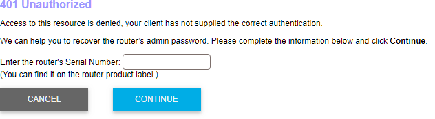

Lol. Well the honeymoon appears to be over. I cannot log into the web interface this morning. Keeps asking for the UID and password and says the connection to the site is not private. It's still routing and functioning normally, but I cannot do anything on the router page. I can log into the debug.htm page for the router, but not the main interface.
Interesting. After so many attempts, I get the attached error page.
- tagteamVirtuoso
orbirick wrote:
I can log into the debug.htm page for the router, but not the main interface.That is strange. However, I have noticed that whenever I log in to the debug.htm page first and then delete just "debug.htm" in my browser's address bar, I get returned to the main interface without having to log in again.
tagteam wrote:
And now it’s letting me log into the web interface. Go figure.

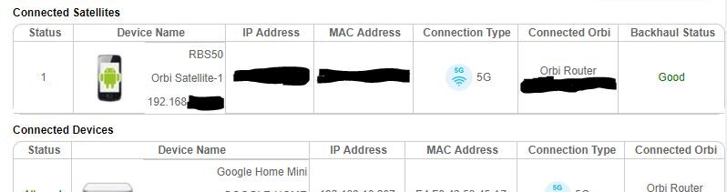

- aazVirtuoso
The devices not showing to which satellite they are connected is a known issue and the forum moderators have stated that Netgear is working on a fix for next firmware release. 2.1.1.16 is relatively stable, but I did run into an issue after running about a week on it where some devices could not connect to internet through Wifi, even though they are connect to Wifi just fine and able to access LAN. The only thing that seemed to fix this was rebooting the router. I hope that this was just a one time occurance, or is because of some memory leak that will be fixed with next firmware and does not occur more than once a week.
Haha, since the FW update, my satellite thinks it's my Android Phone that I used to initially set things up (see attachment).
So, um, yeah, it's a satellite, not a phone
Mind you, I've done factory reset of both the router and the satellite since then and only set up with the web interface, yet some routing table or similar still has data embedded that tells the router/satellite that the RBS50 satellite is my LG V20 Phone in terms of name and graphic, but it identifies the product type correctly. I manually changed the name back to RBS50 before taking the screenshot.
What a half-baked POS effort from an otherwise great networking gear company...so disappointed in Netgear.
