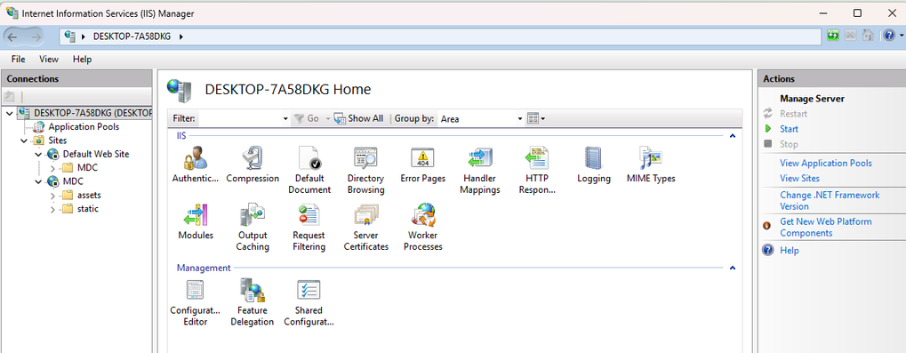

Ok so forgot I had an IIS server going at one point for a project - so I know that admin login from the log on 192.168.1.2 - like it when things made sense.
I shut down the IIS server just to be clean....
