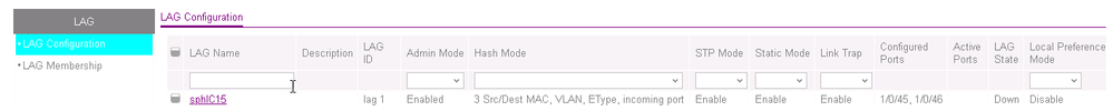

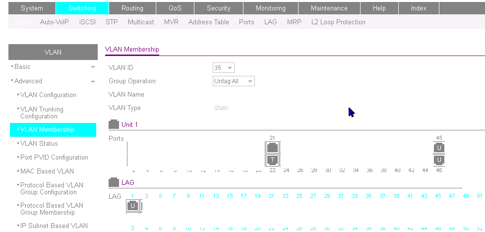

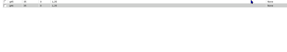

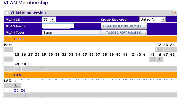

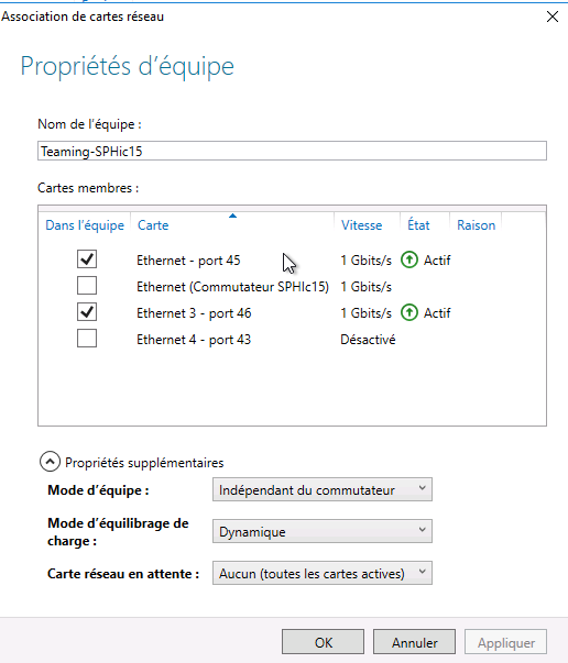

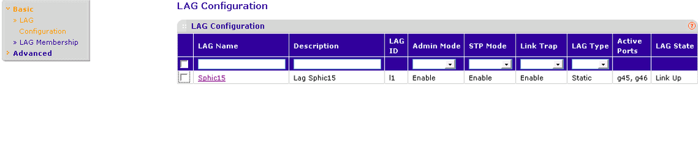

Hello, I try to replace a old Netgear Switch (GS748Tv5) by a M4300-52 G. 2 switches are stacked. I have a Windows 2016 server (vlan 35).
The server is connected to the old switch through a teaming (see below the configuration - port 45 & 46)
LAG:
VLAN :
PVID:
Teaming conf on 2016
I try to connect the teaming to new server with the same configuration (see below the configuration - always port 45 & 46). The server seems to connect but i can't remote desktop on it (ping N_Ok). I try a reboot but same result.
LAG
PVID:
Any help will be appreciate. Thanks. Benoît
