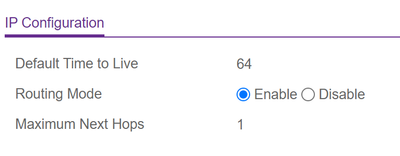

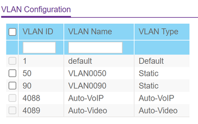

'I have a new GS752TPv2 switch. I am hooked up to my Fios router. I was able to change my switch's IP address and wanted to play around with VLANS. I added 2 VLANS (50 & 90). My local network is 192.168.1.0/24. I am getting a DHCP address of 192.168.1.181 on my machine through the switch. How do I access the VLANS I created. I've attached the steps I've taken. Am I missing something?
I enabled routing mode

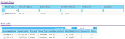

I went to set up a default route and noticed entries had been created for my VLANS.

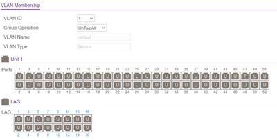

Under VLAN membership port #47 is a tagged port under the default VLAN. What should that port be under the other VLANS? A T or U?

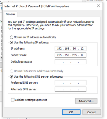

One way of accessing the VLANs you created is by untagging a port and setting its PVID with that VLAN, since the switch doesn't have a DHCP server, you'll have to set a static IP address on your computer.

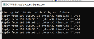

I think I'm with you. The switch is transparent when it comes to DHCP. So the IP range will need to come from the router? I have a sophisticated router at work. At home I have a simple Fios router that does not support VLANS. Port 47 is the laptop I am using. I do have a desktop nearby. If I set a static IP on one of those VLANS to my desktop I should be able to ping it from my laptop if it's on the same VLAN. I switched my laptop and I am able to ping the switch GUI at 90.1. That makes me think everything is working. What I am missing is the DHCP server functionality. When should I tag and untag ports?

Usually, you tag ports if they are connected to another switch or any device that recognizes 802.1Q tags where you want multiple VLANs to pass through it and then untag ports if these are end devices such as computers, printers, and such.
