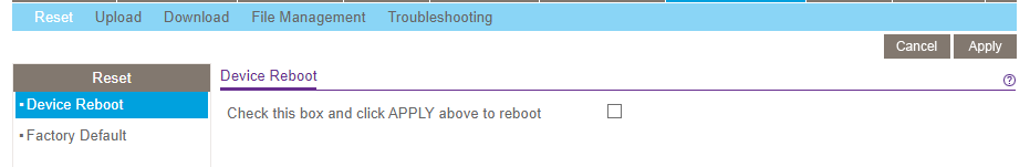

  • (The help also doesn't mention: a manual reboot is required to get the FW change to go live...)

    Note: After activating an image, you must perform a system reset of the switch to run the new code. The switch continues running the image shown in the Current-active field until the switch reboots.
    Depending on the generation, some switches have - to make a little bit more confusion - both a [Reset] (doing just a soft reboot if there are two buttons) and a [Factory Reset] can be present.

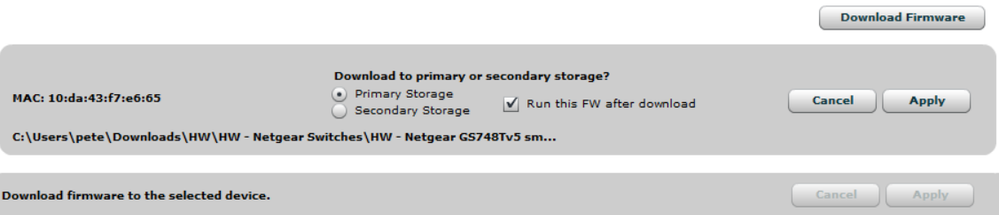

      Here's a screen shot of the download UI in SCC for the GS748T:
      SCC gave me the option of which partition to use. I selected the second partition, which was correctly used.
      Sure looks like it ought to work 😉 .But it did not.
      SCC claimed to have successfully "downloaded" the file. As I discovered later, once I found the File Manager, I saw that it did download something into the secondary image storage area. However, the result was an incorrect version number. (Doing the same thing later from the switch web interface, with the exact same file, didn't have that error 😉)
