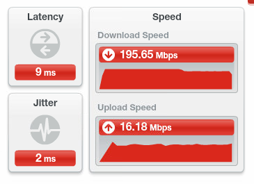

Creating a new thread to focus on this one issue.  I don't believe this is a general slow wifi/slow internet issue, but is clearly Circle related.
All tests done on wired connection via my Netgear R7000.  I have a cable internet plan advertised as 150/15.
This was all done on firmware 1.0.9.14, and I did a factory reset and setup my options yesterday fresh.  I have never enabled QoS or Web Traffic.
I do have IPv6 configured and it works.

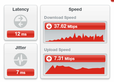

Circle was enabled now for 24 hours.  Speed slowly sinks down to 37Mbps.  I see this speedtest:

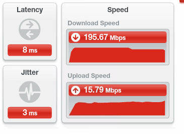

Turn off Circle via webpage on router and hit apply.  This saves quickly, no reboot of router.  Now I see full speed, and see how solid the download speed is?

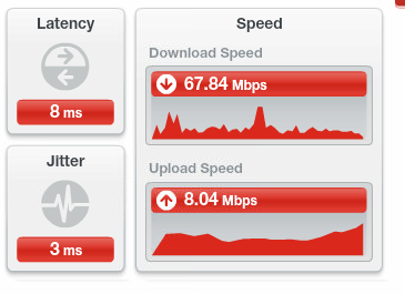

I turn Circle back on, hit apply and I get this speed test.  All tests run inside 2 minutes:
Turn Circle back off, and retest.  Going to leave it off for 24 hours now to test:
