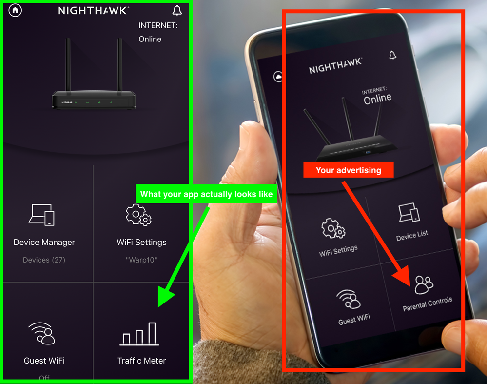

New Nighthawk App - where are the parental controls??
As suggested by Netgear I had set up an OpenDNS account and used the Netgear Genie App to enable / disable the parental controls on demand.
Today I was forced to upgrade to the new Nighthawk App - and the parental controls are gone.
I have now no way to turn parental controls off - I have to go through the OpenDNS site. This is a major inconvenience, as it was very useful to be able to just turn the Internet on for 5 minutes even during a configured 'down' timeslot.
Any reason why this feature was removed ? Esp. as the screenshot of the Nighthawk seems to suggest that it is still there ???

        Is it the firmware that has disabled Parental Controls or, as the first message from patsch says, the Nighthawk app?

      A little bit off-topic - Netgear does fail again to make things clear. Why on earth don't they use the term "Circle" or "Circle by Disney" also on the App? No, they replace it (apparently) by a tile named "Parental Control" and confuse both the Live Parental Control (OpenDNS based) as in place on many Netgear routers.
      Back to Circle by Disney issue - Netgear has published yet another marketing video https://community.netgear.com/t5/Nighthawk-App/Manage-Your-Network-amp-Get-More-Out-Of-Your-WiFi-With-The/m-p/1744185#M9451 stating:
      "From the app dashboard, you have easy access to these features:
      • Device List — Monitor the devices connected to your network and pause the Internet to any device.
      • Internet Speed Test — Check the broadband speeds from your service provider.
      • WiFi Settings — Update your router’s firmware and personalize your network name and password.
      • Guest Networks — Set up separate WiFi access for guests.
      Smart Parental Controls — Easily manage content & time online with Circle® with Disney.
      • Remote Management — Easily monitor your home network anytime, anywhere."
      Yet another marketing lie, isn't it Dustin_V  ?

      Netgear shot itself in the foot by introducing a new app before it was fully cooked. At the beginning of the year it published a video of the all-singing, all-dancing new NIghthawk app. Unfortunately, some months later too many of the feature demonstrated still don't work in the production version.
      My guess is that parental controls and other missing features will return, but such is the pace of software development at Netgear that I am not holding my breath.
