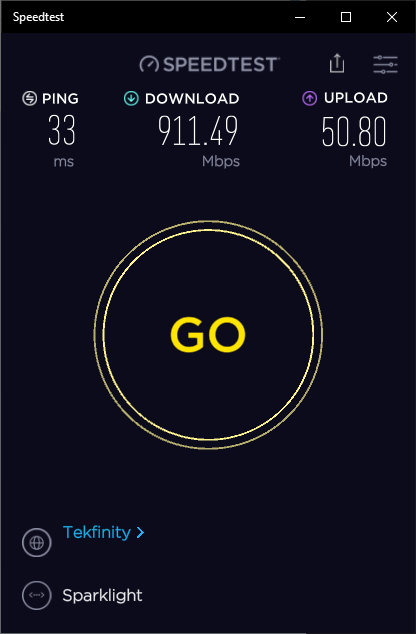

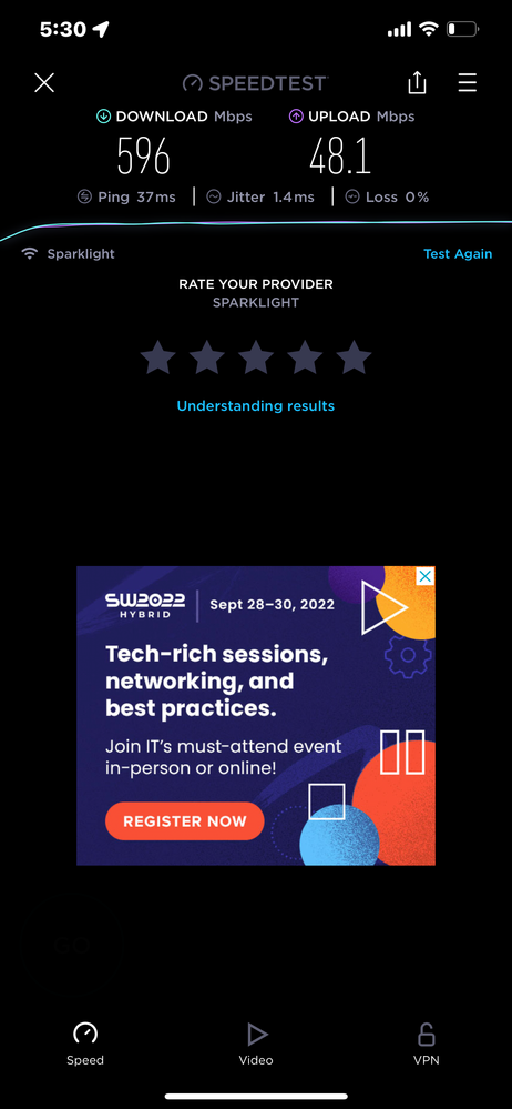

      • FURRYe38's avatar
        5Ghz speeds are good:
        ASUS GT-AX11000 in wireless bridge mode.
        iPhone 12 pro max is seeing to spec speeds as well for 5Ghz AC with 160Mhz enabled:
