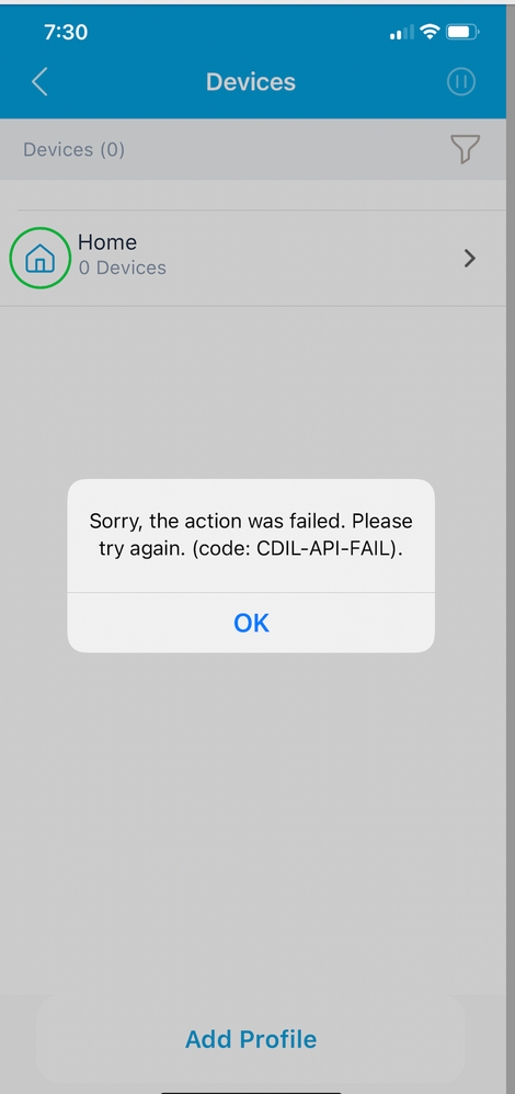

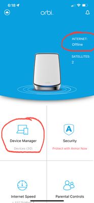

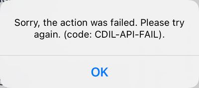

1. Every time I tap on Device Manager I'm getting an error "CDIL-API-FAIL" error (screenshot attached) and no devices are being displayed. I do see all my devices in the web admin interface, so I'm not sure if it's an error with the Orbi app or with the router's firmware (4.6.5.14 currently running)
2. On the main screen the Internet status is reported as "Offline" although everything works fine (devices connected to Wifi have Internet connectivity). Not sure if this issue is related to #1 above, I'm guessing not.

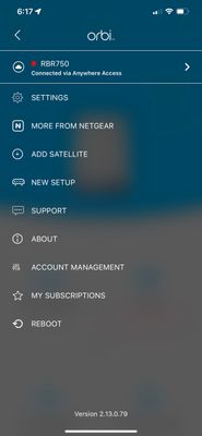

Orbi app version (screenshot attached): 2.13.0.79
RBR750 firmware: 4.6.5.14

  • I have, just this am, started getting the same issue. Firmware version 2.7.3.22. I do have internet access, and everything is working fine just do not have control from the iOS app. I can log into the router via my PC and see that everything is connected as usual. Error shows up as follows:  device offline:: CDIL-API-FAIL

  • CDIL-API-FAIL error message display always when tried to access the devices from Device Manager in orbi app on my iphone.
    However sometimes when I reboot the router then devices are displayed but again next time same error appears.
    Refer to the screenshot for more details.
    Can anyone please help me resolve this problem.
