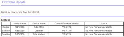

- robot1125Aspirant
I'm a little confused about version numbers. My RBRE960 and 2 RBSE960s are all running v6.3.7.10:
And the admin page as well as the Orbi app say no new version available.
Yet I got an email saying a new version is available, and this thread seems to concur (v7.2.6.21)
Should I manually update?
Yes, please reveiw this and give it a try:
