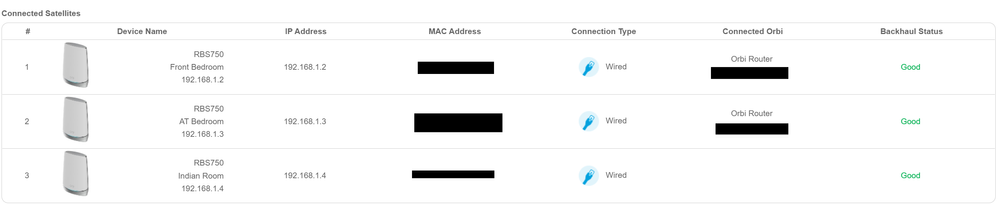

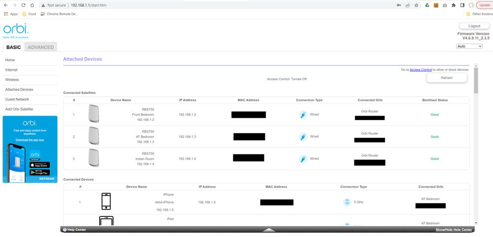

    Hi,
    I am just opening up this thread again as I am experiencing some issues.
    To recap I have an RBR connected to 3 satellites (all on 4.6.9.11) via ethernet backhaul Cat5 (within the walls so difficult to change to Cat 6). Sometimes, all of the satellites shows a "connected orbi" as in the attached screenshot. I don't generally have any Wi-Fi connection issues when this is showing.

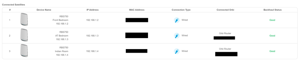

    Sometimes however, one or more of the RBS units do not show a "connected orbi", as in the second screenshot (in the next post).
    The symptoms I am experiencing are wifi devices, that are already connected to my network (even ones with reserved IP addresses), not getting allocated an IP address (or allocated a 169.254.xxx IP address). This is usually noticeable when I move to a different part of the house (roaming?) and the netgear log shows that the device is asking for an IP address. Or perhaps when the lease time for the IP address ends? This is noticeable on my iOS devices (like iphone/ipad). It is intermittent and lasts for about 2-5 minutes - the circle on the iOS device spins continuously and eventually it will connect.
    I am not sure if the symptoms are related to this "connected orbi" issue. Could it be that the Wi-Fi device is connected to the RBS that does not have a "connected orbi/router" hence not being able to get an IP address allocated to it as it thinks it is not connected to the router? It is strange that it is intermittent. And even if a RBS is not showing a "connected orbi" the wifi/internet works fine when my device is connected to that specific satellite.
    Any help would be greatly appreciated.
