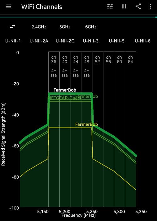

    I found that visually when set to 36 it looks to be centered on 42. The app I use Analiti shows both what is being seen and statistically and the dominant frequency is 40.

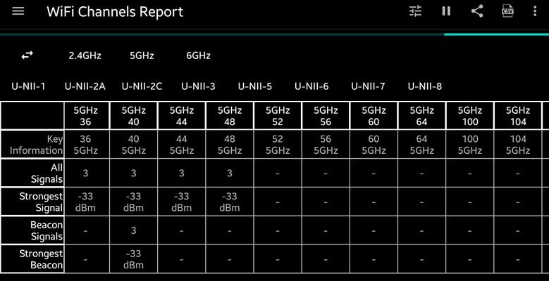

  • I just tried channel 36 & can 100% confirm the "bug"
    Shows channel 40 in the web GUI along with my WiFi analyzer app but channel 36 is selected in the radio button drop down in WiFi setup.
