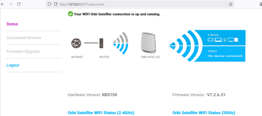

- dbrb2Apprentice
Actually the RBS is up
But not functional and can't, apparently, see the RBR
But not functional and can't, apparently, see the RBRHow strange. The diagram appears to show that the 5G link between router and satellite is "up" and that devices are connected to the satellite at 2.4G.

As a last ditch attempt (turns out to be a bad idea) I updated the RBS firmware to the latest using the file from netgear support pages.
Now the RBS gives me a 404
Feels like this is a problem that may be best solved by using different hardware :-)

The current firmware is v7.2.7.15 It was created Feb 28, 2025. The satellite clearly has v7.2.6.31.

Yep - you're right about the firmware. So the RBS problem was not caused by an auto firmware update. RBR maybe was - but I can't check that :-)
However, in my attempts to fix this evening I downloaded RBS 7.2.7.15 and uploaded that to the RBS - and that made things worse (404 error on the RBS now)
