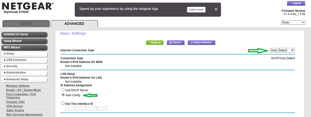

NOTE: May have long awaited DNS Probe/Proxy fix. Enable IPv6 Auto if you continue to see DNS Probe or Proxy messages in browsers.

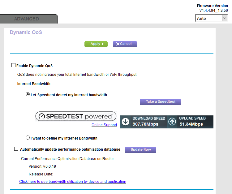

- Performance Optimization Database corruption - the version and release date were blank and I don't think they were working. effects were higher ping times (sometimes into the 1k range) and pages not loading correctly. I do not have a 1Gbps connection so this feature is needed by me. my subscribed internet speed is 10Mbps down / 1Mbps up.

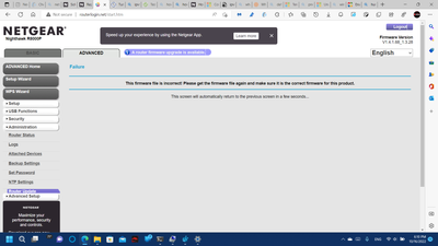

Also.. router autoupdate lists this version but fails to install. attempting to do a manual install results with the router saying the firmware is incorrect.
Are you sure you downloaded the correct FW file for your model Router? There are 3 different models listed in this thread.

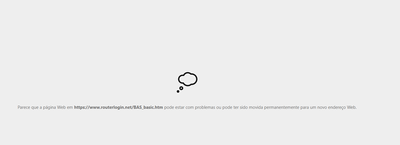

one moore bug detect.
After test de internet connection show the next windows.

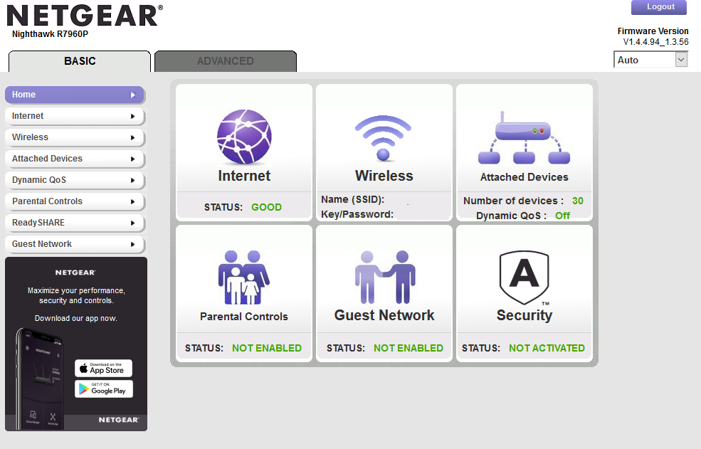

I have the Nighthawk R7960P with V1.4.4.94_1.3.56 and has been working pretty good. I have lots of devices attached to it about 40-50. I usually add them to the LAN Setup and assign an IP address to avoid conflicts. Lately it does not let me add new devices with the error message "Invalid MAC address. 2CAA8E6B596A". This message is displayed for existing devices I want to rename or new devices I want to add. Thinking that it might have run out of space. I removed two old entries. With no luck. Using the App at least it lets me rename devices, but the app does not have LAN Setup menu (or I don't know how to get it).
