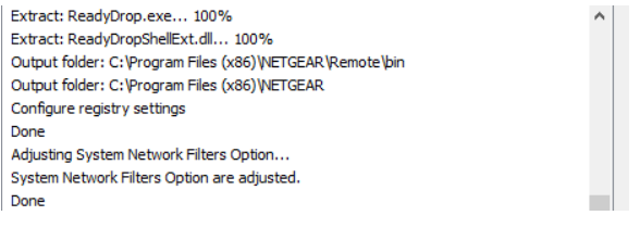

    Hi nextwavepc Guvner27 ,
    I saw 2 issues on the screenshot.
    1. The code appears on the readycloud app.
    2. ReadyCLOUD can not be installed, will be stuck in the registry.
    Is there any security software on your PC that will prevent Readycloud installation?
    If the code appears on the readycloud app, please install this patch package and try it out.

        Hi Guvner27 ,
        Your situation should be the second situation I said, you need to check the registry, the normal situation should be my screenshot below.
        "configure registry settings" . We also need to check the version of the windows. What is your version number?
