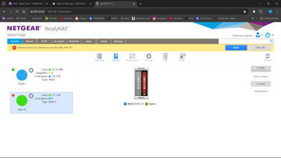

readynas102 it was raided, one drive failed. A new drive was inserted but nothing was recovered and the working drive was not accessible, I made the recovery USB (many times) eventually it turned off. On reboot I can see both drives, the new drive is accessible, the second with the date on is seen but not accessible, i can see the volume of data but cannot open the drive. I removed the drive, docked it but the PC is not seeing the drive. How do i "un-lock" the drive or re-raid it in the readynas 102? I cannot afford to format and loose this data. I have reclaime installed but as the dock is not recognising the drive it cannot be used ..any help?
Can you download the log file zip from the logs page?
Also post a screenshot of what you are seeing on the volume page.

the original set-up was x-raid, i did attempt to change it to flex, the damaged drive has limited options when highlighted
